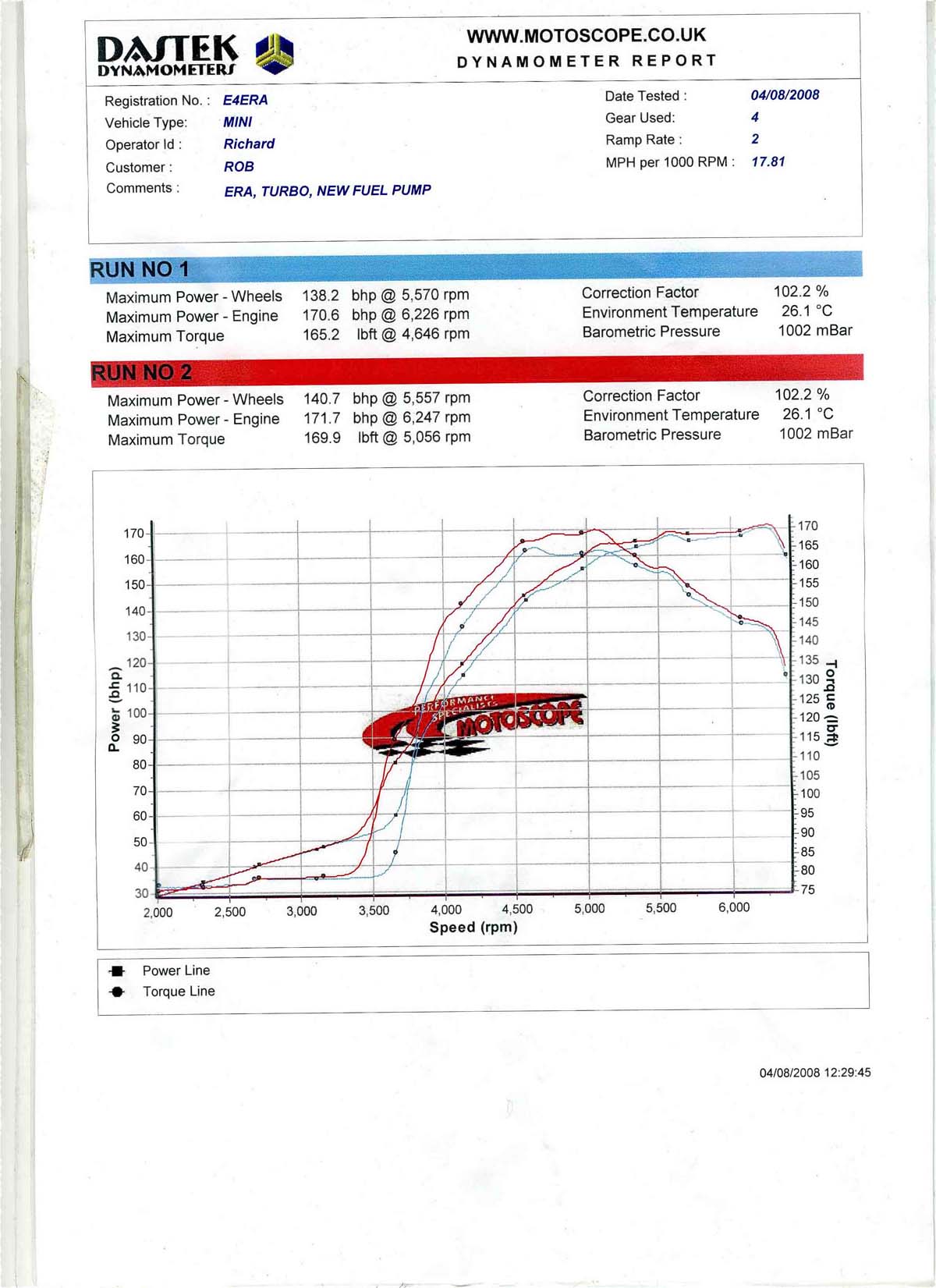

will dig out the rolling road printout.....

Post by moremoremore » Tue Feb 10, 2009 4:03 am
Here we are ...

Not put on nitrous (I may or may not in the future) ...Its running 172 bhp...completely on its own merits... 8) however, there is lag...just makes it more fun when an extra 100bhp comes in within 3500 - 4500 revs.

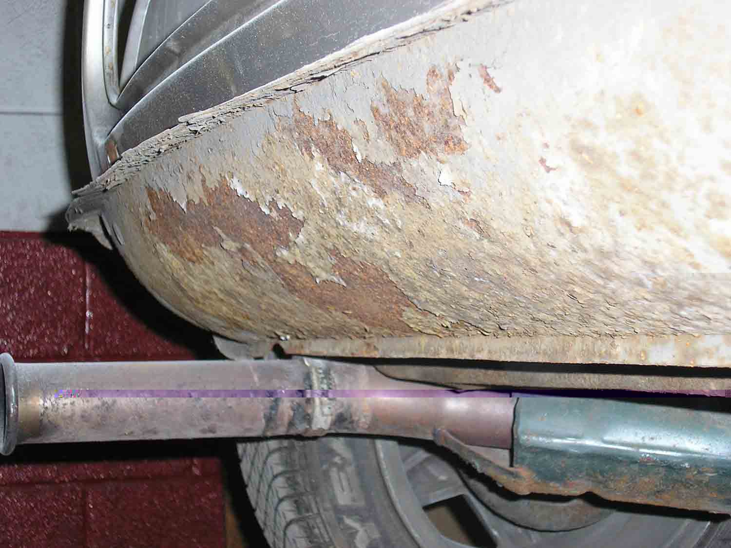

Post by moremoremore » Thu Feb 12, 2009 4:01 pm
a selection of before pics

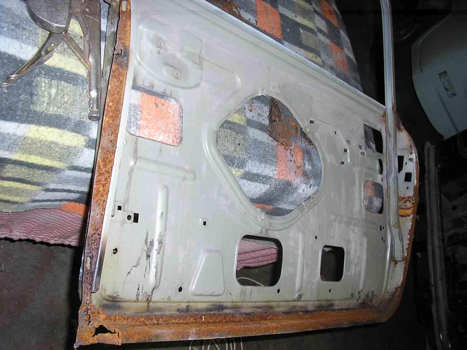

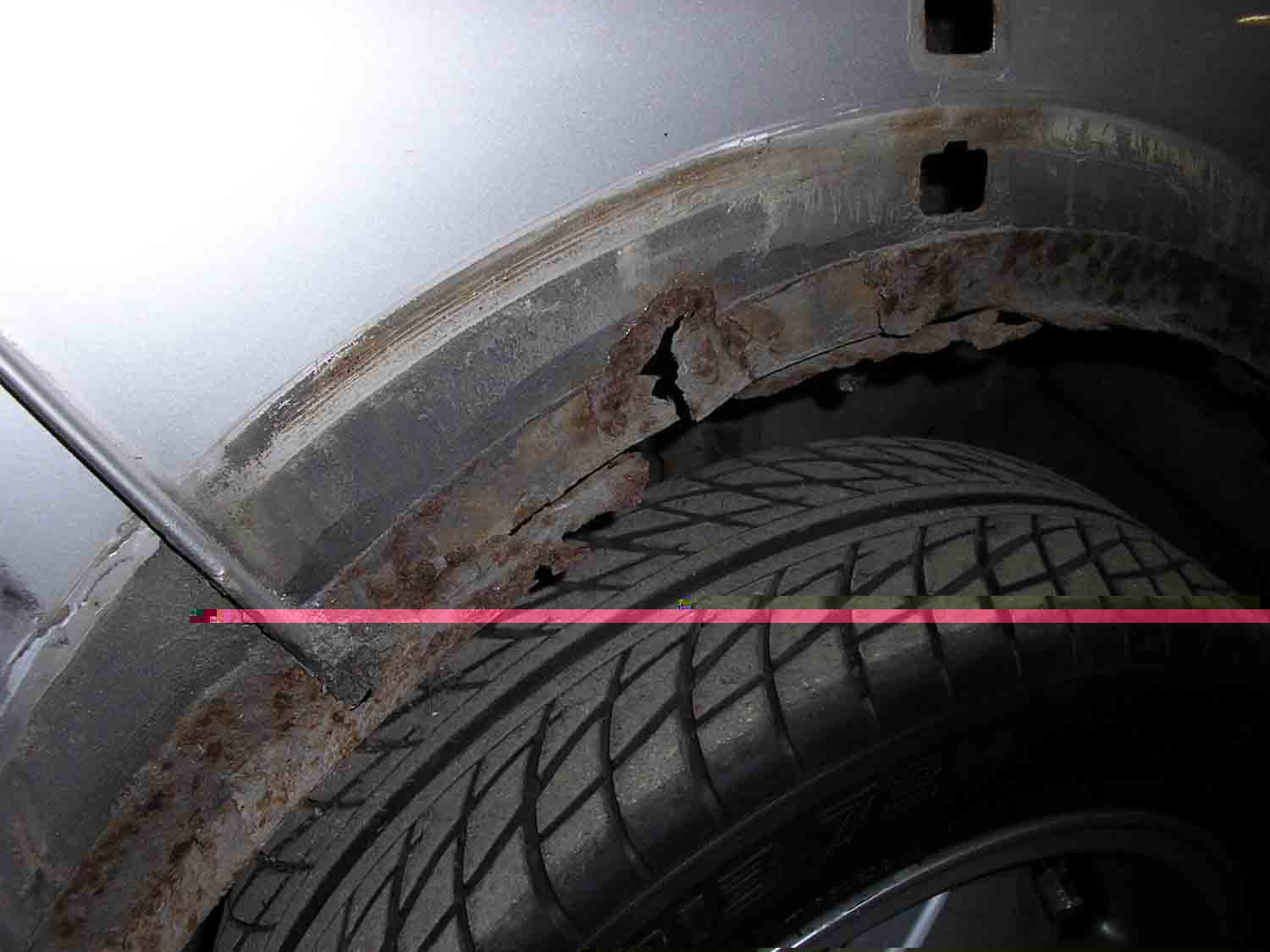

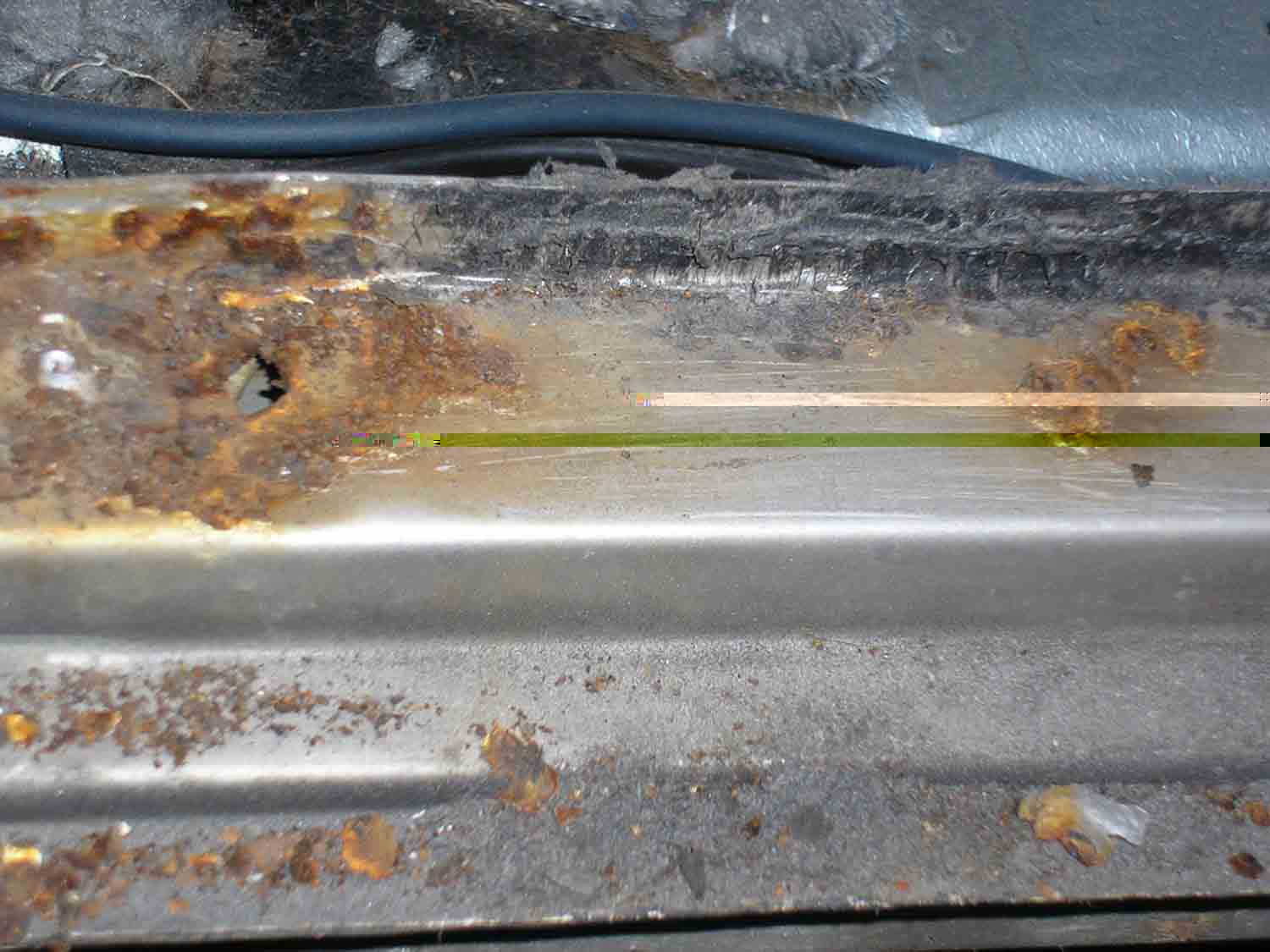

moremoremore
Posts: 20
Joined: Fri Feb 06, 2009 11:09 am
Re: Newbie
Post by moremoremore » Thu Feb 12, 2009 4:03 pm
more
Re: Newbie
Post by G96LUE » Thu Feb 12, 2009 7:09 pm
Ooooh that was a little crusty.
makes it even more incredable to see the results you have achieved.
