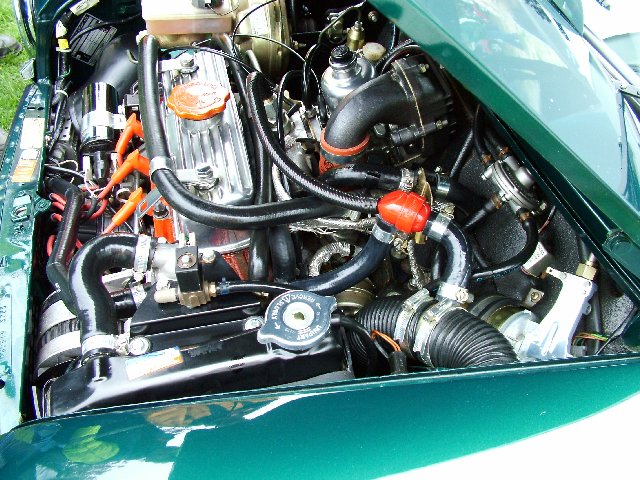

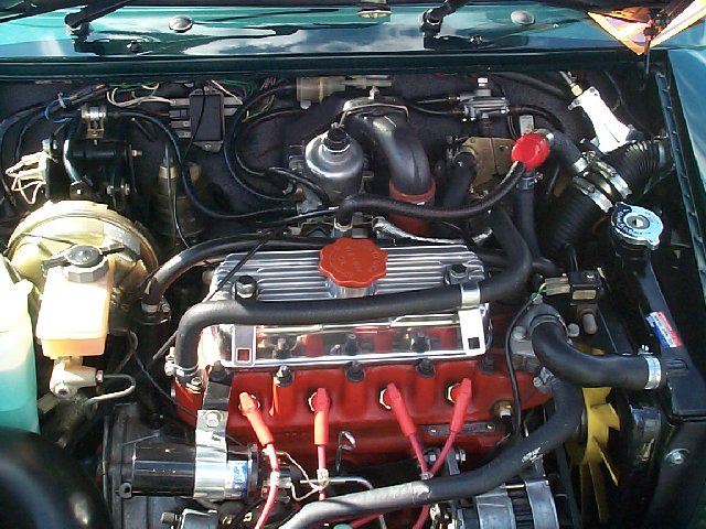

p.s i have attached some photo's which might help.

- turbo2.jpg (20.23 KiB) Viewed 28461 times
- engine2.jpg (111.17 KiB) Viewed 28461 times
- engine1.jpg (94.17 KiB) Viewed 28461 times
