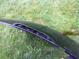

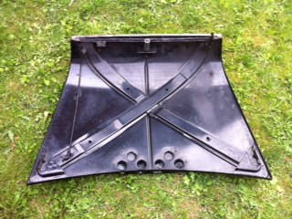

In our parts I have a bonnet from a Turbo car from Japan that was scraped. I want to confirm this is indeed an ERA Turbo factory bonnet as I have been told. It certainly doesn't look like an add on aftermarket bit, as the vent holes in the bonnet are very professional looking.
I included a shot from the tail edge and the underside to show details.
Anyone able to confirm if this is from an ERA? I guess the follow on question is what is it worth being a rust free one.

- Bonnet trailing edge detail
- TrailingEdge.JPG (36.9 KiB) Viewed 17705 times
- Bonnet underside detail
- bottom.JPG (36.41 KiB) Viewed 17705 times

Welcome!
The bonnet certainly looks like a genuine ERA item, the holes look to be in the correct place. The holes should be 38mm (1.1/2") in diameter - if they are then the chances are it is a genuine bonnet. What is it worth? Ha well the question is what it is worth to you!
To re-create an ERA bonnet you need a standard one and then the Q max cutter and hole flare punch - both of which will cost around £100. So to recreate a bonnet from a Heritage panel (minus scoop) is going to cost about £250. I cant see from your picture if the bonnet has the usual crease caused by a stiff bonnet hinge which would devalue it a little.
If is possible to replace the grille surround support lip on an ERA bonnet, which is the usual area they rust. This is available from Minispares.
I have not seen a real ERA bonnet scoop available for some time - if that is in good order I would value that at £40 - £50.
Stick it on eBay and let the market decide! We will be watching!!!!
