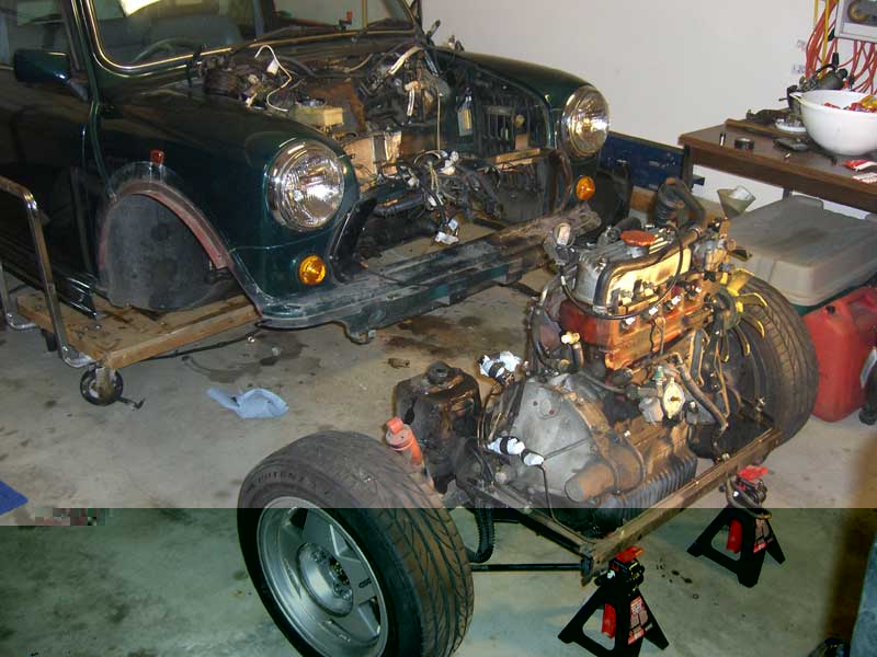

Ok, the engine and subframe have been removed. Here is a picture of it removed. Next step is he rebuild... :) Oh and we didn't have to remove the turbo, but to make things a little easier the rad, starter and AC pump were removed. We then put the subframe on jack stands and two of us lifted the body off while the other made sure everythin cleared properly. The car is heavier than it looks.

Post by G96LUE » Mon Dec 21, 2009 1:46 pm
You are right, the body is a lot heavier that it looks.
It's good you had help.
When i did mine, i did it on my drive all by myself.
I supported the engine / subframe on a trolley jack and undid the steering rack bolts to keep the wheels pointing in the right direction.
I then used another trolley jack and axle stands to lift the body inch by inch until i could wheel its heart out under the front.
I'm glad i had my garage built this year so i can keep dry and wind free while i'm working on it over xmas.
