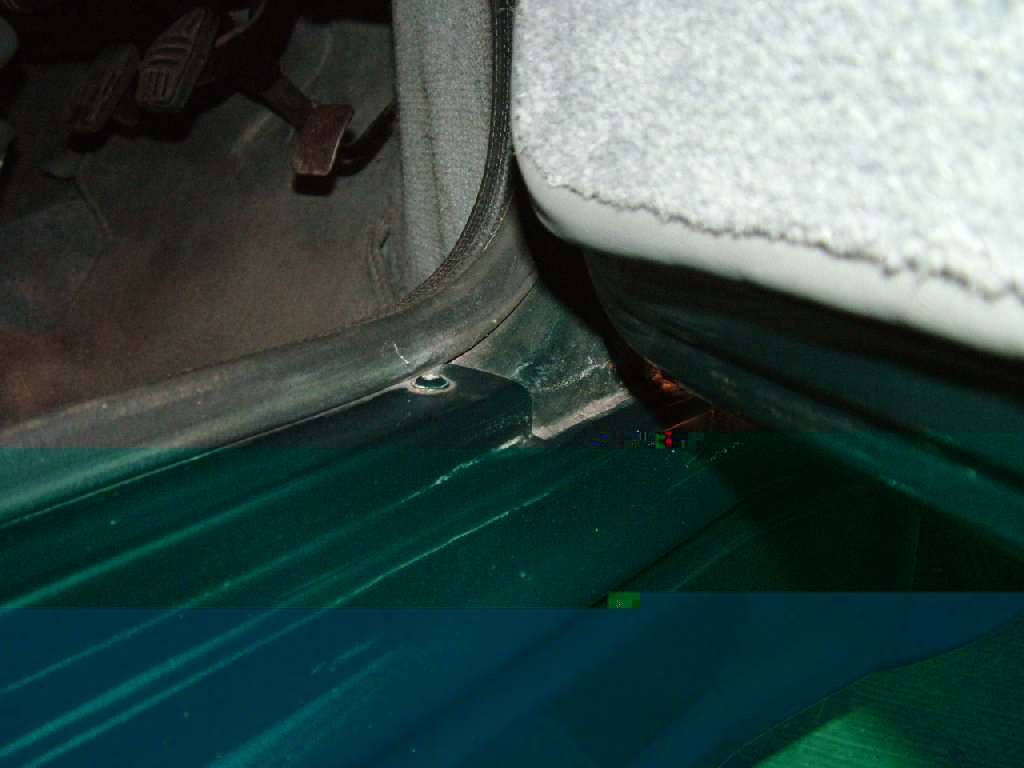

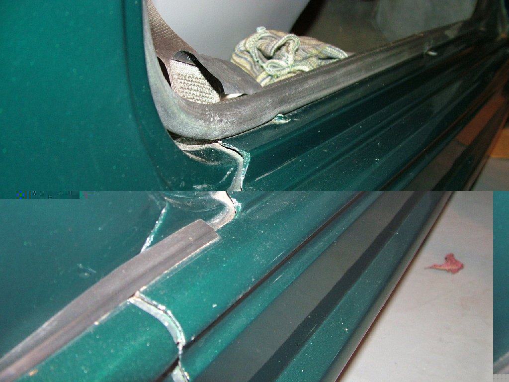

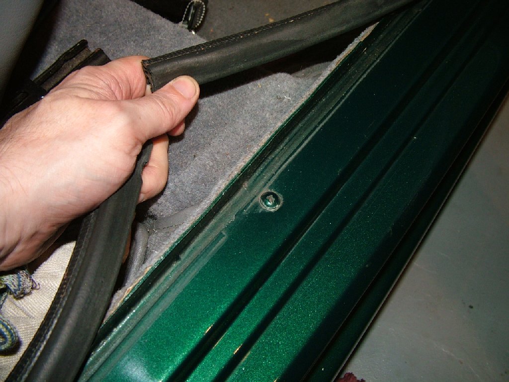

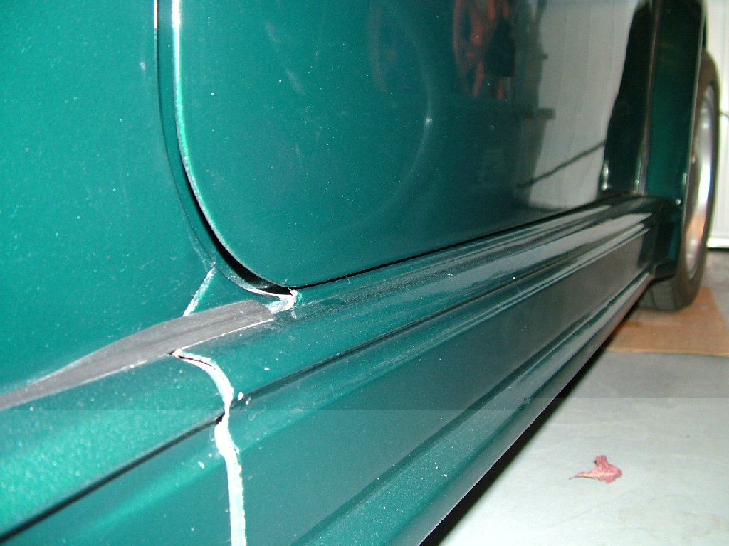

I need to see the way the body kit fits into the door opening. I need to see how much is trimmed off the kit to allow the door to shut. I have a couple of photos but they are not too clear. If possible the shape of the kit as it passes the bottom of the A panel and goes on to the step. The depth of the door step top and how far in the rivets are and, the other end of the doorstep as it comes to the B post and back out along the rear 1/4 panel. Apart from that the restoration is going well as can be seen on the other thread Restoration R1028.

i have been a little busy, but here are a couple of pics.

another pic
