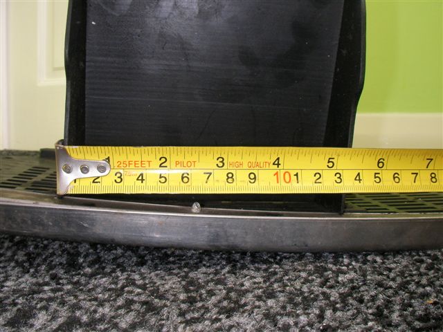

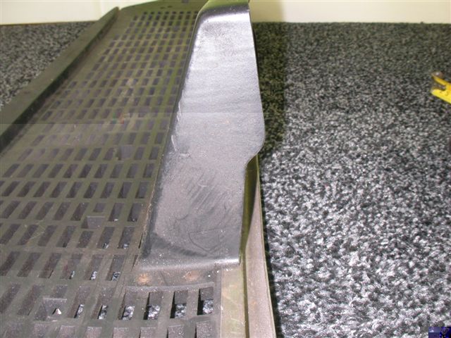

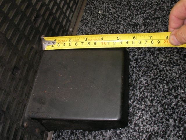

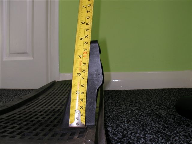

Oil cooler scoop photos added also
http://www.rimmerbros.co.uk/Item--i-EAM9332
- SANY0070.JPG (42.9 KiB) Viewed 32237 times
- SANY0067.JPG (75.11 KiB) Viewed 32237 times
- SANY0066.JPG (65.55 KiB) Viewed 32237 times
Re: Era Cap / Parts?
I have a few more photos if you need them.
Please post the pics.
Than everyone who need the part can build one.
Excellent thanks.
The pics are great. I should be able to make one from that.
I see it is riveted to the grill.
I don't suppose you have a pic from the front of the grill you could post.
This will help to show how far it is fitted from the RH grill edge as well as what its riveted too.
I didn't realise it was fixed to the grill as this will make i easier to make and fit.
I might order a couple of washer jets as long term spares before they are gone forever. Thanks for the link
