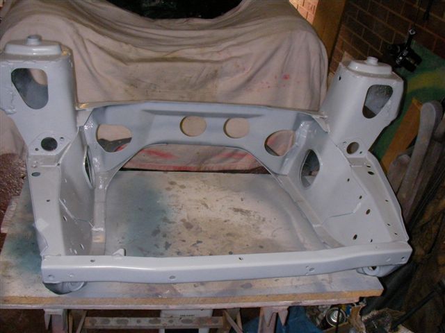

Hi everyone.
My front sub frame has a curved front to it. As far as I can see the curved front sub frames were put into MK4 1300 models from 1990 to lower the engine and bring it forward . Although the registration year of mine is 1992 I think it was built in 1989. Everything is right. all the holes in the right places the oil cooler brackets are all as you would expect from ERA the steel brake pipes are all as you would expect to see them and not home made I know that the straight front sub frame is in the ERA. Can you have a look at yours and see if it is curved or straight as I need to get to the bottom of this. I was wondering if ERA were trying them out at that time before Rover put them into production.

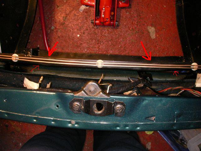

Thanks for the photo.
It is difficult to see but it looks like yours is straight.
The photos of my sub frame are a bit clearer. You can see it in the picture of the sub frame in primer. It is not so easy in the other picture.
Again if others can just have a look and let me know if their front frame is curved or straight. I am still convinced mine is original but why it would be curved and not straight I have no explanation.

What makes me wonder is, that on my car the inner wings are bolted to the subframe. On your subframe the holes on the side of the subframe are missing. Or was mine modified?

I have never seen that done before. I suspect that it is a modification. I am not sure why. I notice that in your photo the fixing for the front body kit has been modified and strengthened as well.

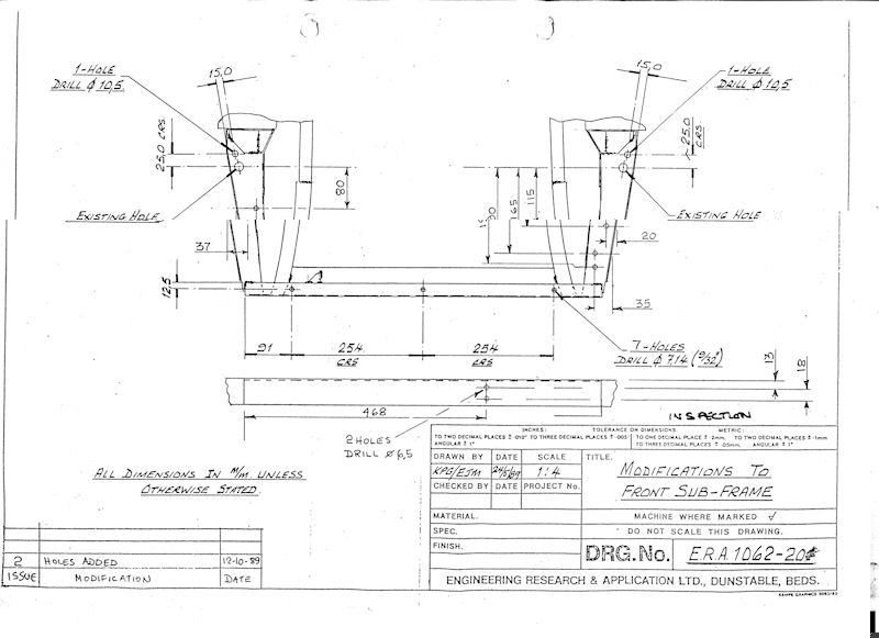

Just checked ERA drawing (attached) and front cross member is shown straight, Dated May 1998.
Was auto subframe curved? Rumor has it that some cars were fitted with Auto frame to move engine forward.

- Front Subframe Mods reduced .jpg (60.87 KiB) Viewed 24174 times

It isn't an auto sub frame. My Riley had an auto sub frame and it had to have a spacer under the near side engine mounting as it is that little bit wider than the manual sub frame, and my car didn't have a spacer. All the holes are in exactly the right places. Exactly as the drawing.
(the drawing doesn't show the holes for the towing attachment. My sub frame doesn't have those holes)
I still find it hard to believe that someone would copy it that well. As I stated earlier it really looks as you would expect from ERA.
