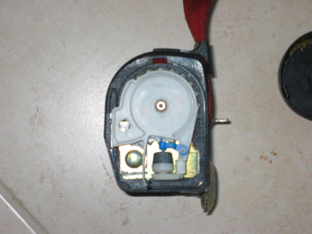

With your old belt you should be able to unclip the plastic cover on the side of the housing, this will expose the inertia part.
Unclip the large tag at the bottom.
You will then see all the locking mechanism.
You will probably find the blue bit is stuck up.
Worth a look if it isn't working.
The spring is at the other end so don't remove that bit.

Post by Jezza » Thu Jun 21, 2012 5:42 pm
Useful advice - pity I didn't see i before i unscrewed tthe other end and 'unleashed' the spring................
