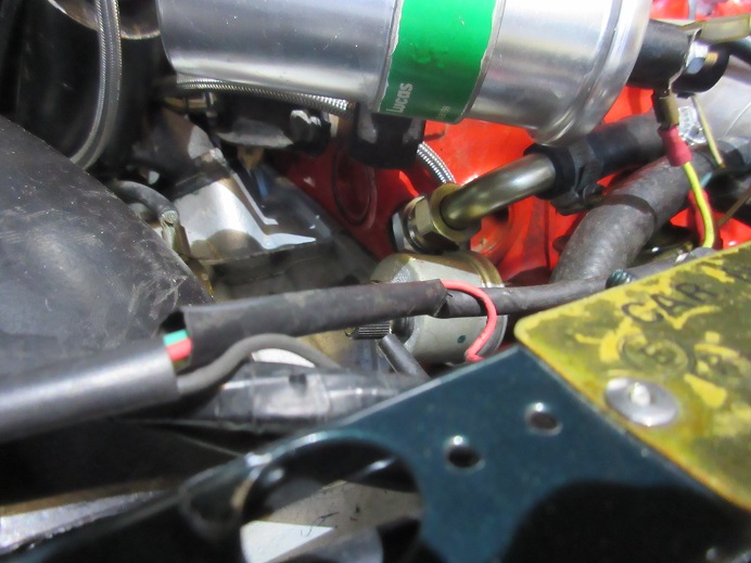

I could not find very much information on the subject so I decided to document my fitting. I am sure there are many other ways of doing it but this is how I tackled the job.

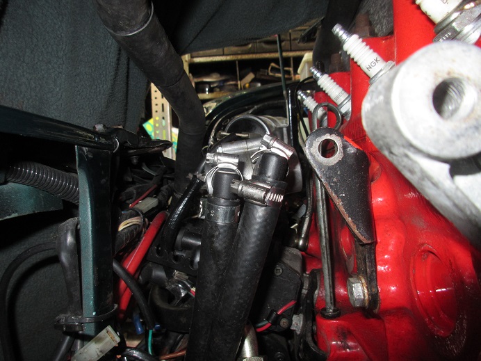

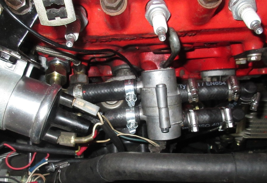

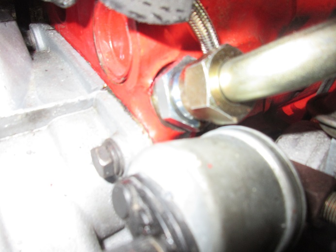

I removed the alternator, coil, oil filter, I disconnected the top hose to the aux rad and loosened the alternator bracket and pushed it out of the way. Next I removed the oil feed pipe from the engine block I then removed the oil cooler. It takes a little jiggling and twisting but it will come out.
I bought 2mtr of Gates 1/2” rubber oil hose and 4 x 90 degree 1/2” BSP elbows, a block adaptor (MOC1 minispares) a filter adaptor (MOC2 minispares) 10 x 00 13-20mm Jubilee hose clips. I also had to find a 16mm/M16 copper washer for the block connection (MOC1).

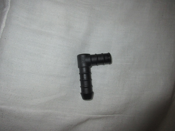

I used 2 x 12mm 90 degree Polyamide elbows to drop the pipes to the cooler so I didn't have to bend the rubber pipe to much to get to the cooler. The material they are made from will resist pressure, oil, and temperature.
The rubber hose I cut into lengths.
1 x 75mm Block to thermostat, 1 x 426mm oil 'stat to oil filter, 1 53mm x oil 'stat to nylon elbow front, 1 x 63mm oil 'stat to nylon elbow rear, 1 x 540mm nylon elbow front to cooler, 1 x 390mm nylon elbow rear to cooler,

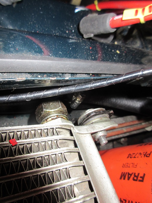

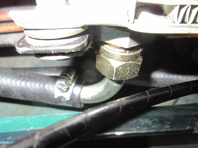

I reduced the front Polyamide elbow by 8 mm (1 section) so it staggers the pipe run as it drops down to the cooler. The Polyamide elbows need to be angled slightly to the front. The new elbows on the cooler need to be angled also, as in the pictures.
I assembled the pipes and made sure it fitted. I then tightened the clamps and refitted the whole lot and made it secure. I primed the cooler through the rear pipe and connected it up. Refit the parts already removed. Make sure coolant is topped up. Check oil.

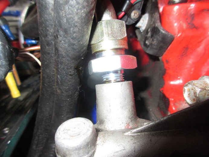

- IMG_3011.JPG (151.76 KiB) Viewed 191203 times
- IMG_30131.jpg (233.8 KiB) Viewed 191203 times
Re: OIL THERMOSTAT FITTING TO MINI ERA TURBO
- filter adaptor
- IMG_3034.JPG (137.47 KiB) Viewed 191203 times
- Elbow cut to reduce length
- IMG_3015.JPG (143.13 KiB) Viewed 191203 times
