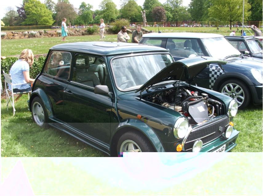

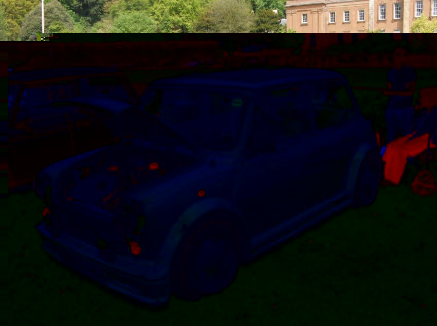

Pics of R1020 (ex-Rover Showcar) taken at Himley Hall

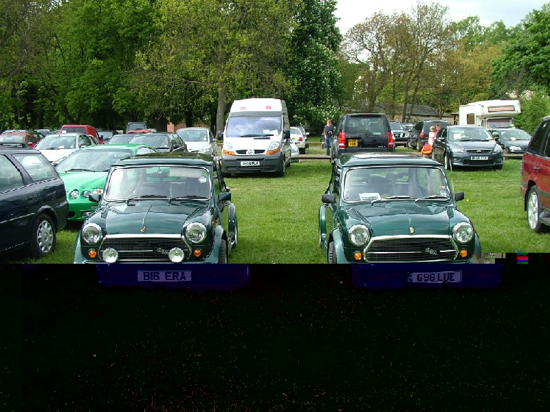

I parked behind B16ERA in the top carpark. managed to ged a chat with Ian the owner and moved the cars for a pic before we left.

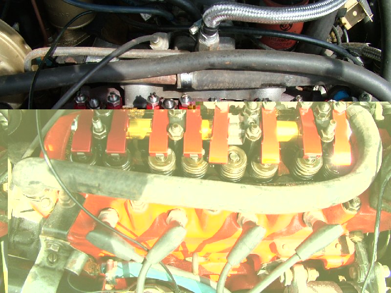

i didn't arrive until about 13:00. i had a little engine trouble. see pic below. Doh.

Ouch looks like the rocker sheared straight accross?
Re: Himley Hall - 10 May 09
Post by G96LUE » Mon May 11, 2009 9:12 pm
Yep.
Minisport recons that is was because i had not set them up right.
Before i fitted them i phoned for advice and all they asked was what cam i had, piper t3, they said that should be fine. I just had to check if there was 40 thou between coils. i checked them and there was about 60 thou in total. it now appears that they meant 40 thou between each coil. perhaps it was my fault, but the fitting instructions didnt make it that clear. expensive for about 12 miles driving.
i now need a new rocker, shims to lift the pillars, and new springs.
guess i will be fitting them to the next head now.

No, it was an exhaust valve so no where for the gasses to go after combustion. luckily i was slowing down for some traffic lights (on the dudley road half way between the pie factory & the B C museum) so was only doing about 20 when it happened.
i only live in walsall and my parents are in aldridge, so i phoned my dad and he picked me up the tools and my old rocker assembly and i swapped it on the side of the road. 1hr wait for my dad, 35mins to fix, so not too bad.
